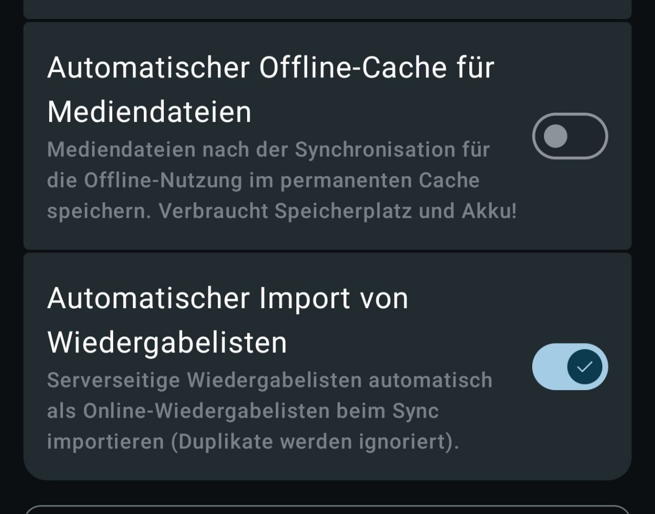

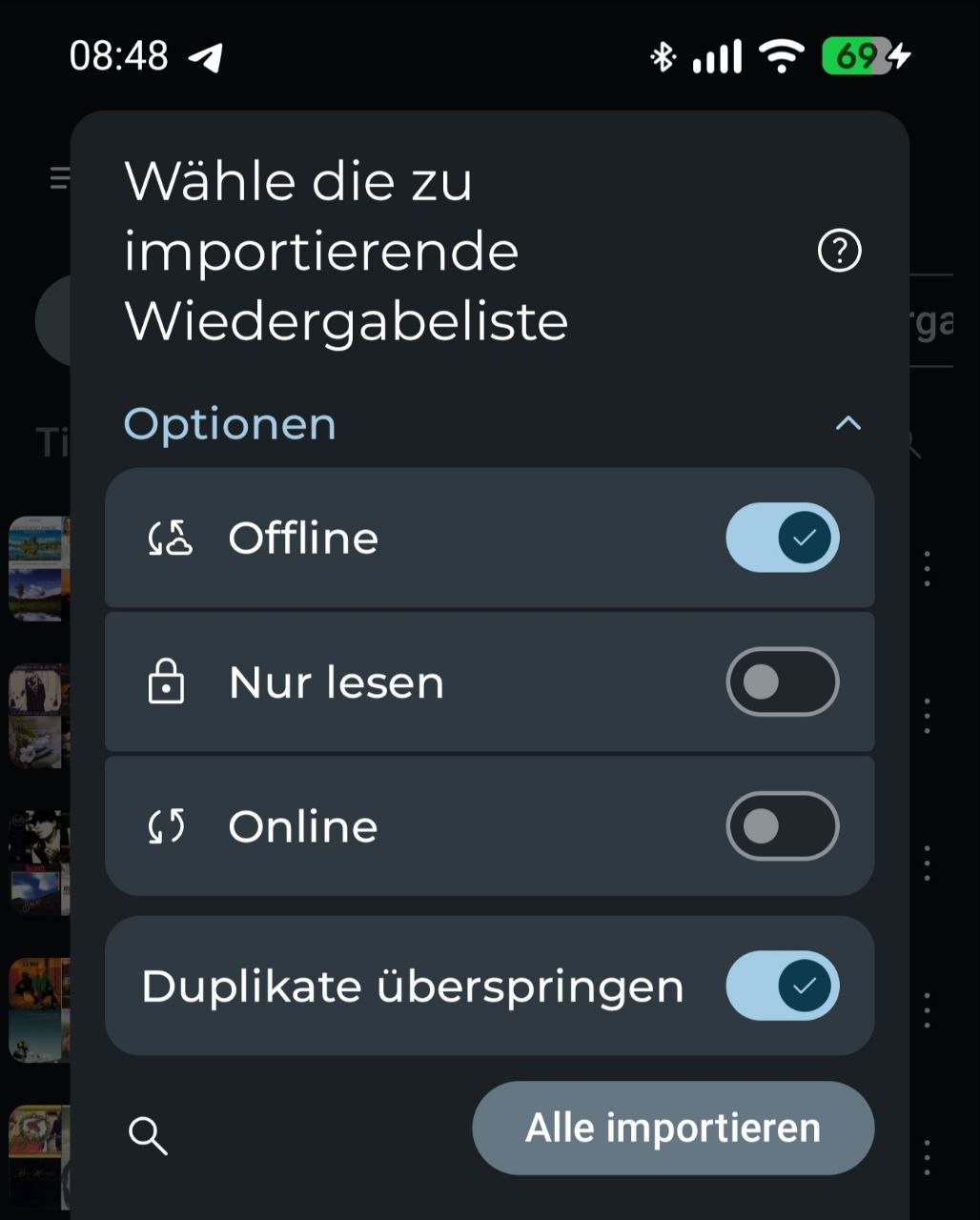

I enabled automatic playlist import under Media Management → Subsonic (see image 1). However, the app still shows “offline” in the import dialog (see image 2).
It’s all in the docs, but again, the import dialog allows to select the mode when you will manually import the playlist. To change a playlist mode 3 dots menu then the options
