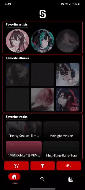

Often when the app first loads (and after exiting Settings), pressing the device’s Back button will return to the main tab instead of navigating to the previous screen in the current tab.
Enable multiple “Main navigation entries” with any navigation style. Let’s use 1st: Home, 2nd: Library.
Enter Settings, then exit. (To freshly reload Home page.) Tap Library tab and open any option (e.g. All Albums).
Now press device’s back button. App will return to Home tab.
