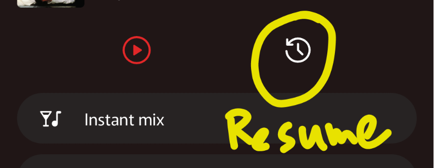

To confirm that there is a resume point, you can tap the three-dots menu button for the track and hit the Resume button there. IIRC the same button should be available on the row of buttons on the Album page.
