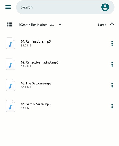

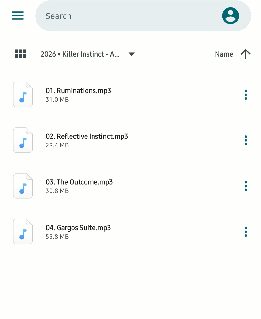

This album is complete, has Metadata, no different than anything else.

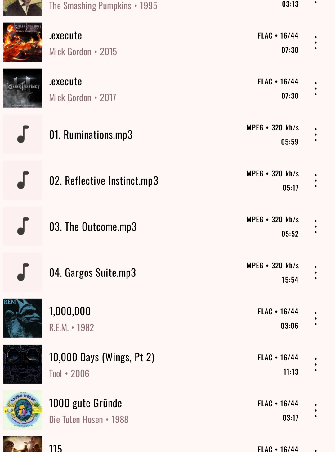

But, it doesn’t show up; instead the tracks are showing but without the Metadata as well. It is only affecting this one. I used Picard Musicbrainz, but, it still has nothing showing on Symfonium.
pCloud
Go to “tracks” to see the disembodied music.

The embedded images are 18MB, the scanner have securities to not explode data usage during scan and limit to 16MB per block.
You can remove the images and use a cover.png in the same folder, or update the images with more reasonable ones.
