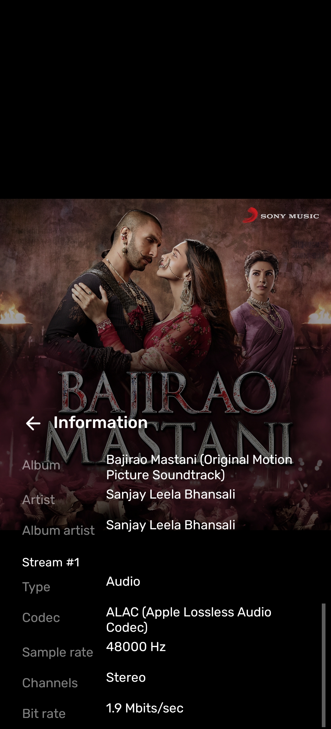

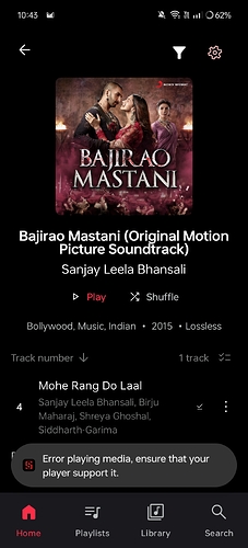

Hi I have this one song with a very weird issue. This song plays super fine on my mac air m4. I tried to fix it myself using few setting misc but the issue remain at that specific point. When I scroll the song before and after that point the song just plays fine without any issue.

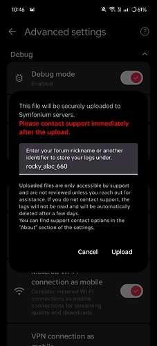

Please look after the issue as I have attached the screenshot, log and the file link to it. I will be buying the app as the app and the community is just amazing.

  1. Open
  2. Play the song
  3. Wait for the 00:57
  4. Song playback crashes
  5. Pain
rocky_alac_660

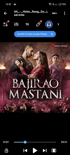

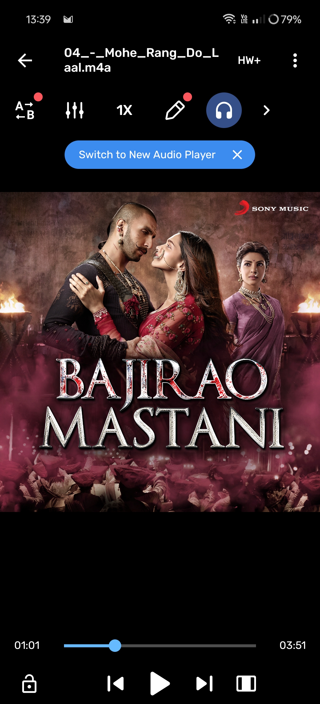

Hi! That you for the research. I understand the issue but the stuff plays without any issue on my mac as well as mxplayer on android too.
I have had no issues with MX Player regarding this specific song. I am too confused about what is this issue.. I hope there is a fix to this.
