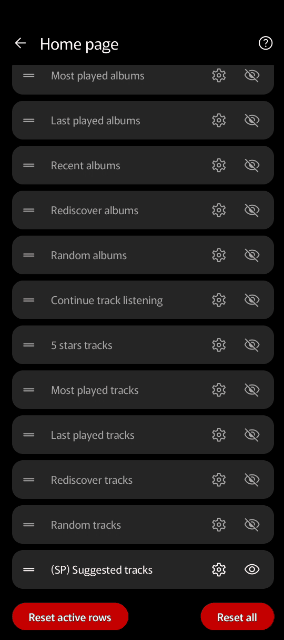

20260223_222043
GIF is “Case 2” after changing target of the playlist. If I had backed out before the crash, there would be no issue at all.
You can see the Home page entry race to the position of A when I scroll up. If A & B are not so far apart, it may race back-and-forth before crashing.
